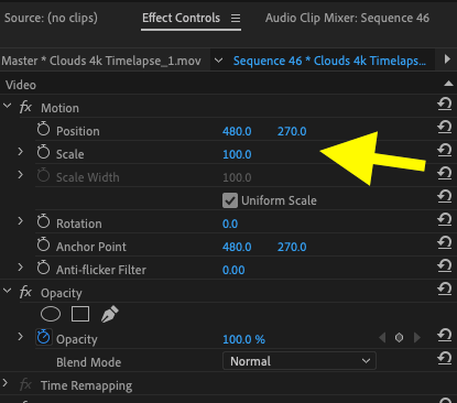

The monitor needs to be set to fit, unless you have a very specific reason for not doing so. Fit shows you the full sequence canvas you are working with. The zoom level only changes the appearance of the monitor, it does not rescale or change the clips themselves - or the scaling of clips relative to the sequence canvas.
To actually adjust the scale and postion of the clips, you need to select the clip on the timeline, then once selected go the Effect Controls Panel and adjust the scale and position setting in the Motion section:
Do this test. Set the monitor to fit and leave it at that setting. Adjust a couple of clips to fill the monitor. Export that adjusted section, the exported file should match what you are seeing in the Program monitor.

Adjusting the scale does not expand the frame just the image. I can go to 110% max without the video image moving outside of the frame. Adjusting the position justs adjusts the position of the image inside the frame. I can't make the frame larger than the existing 1/4 of the whole panel at the centre. This image goes about 25% higher.Music 3.png

Yes. because you created a timeline that has a vertical aspect ratio 9x16.
Since you made that choice, you need to fit all the material within that frame.
Is that not what you want to do?
In the first shot of guitarist, the video is filling frame. the light gray area around the video you see is nothing, you are seeing it because Premiere was designed to display 16x9 imagery. In the second image, the deep black area is the portion of the frame that has no video content.
If your source material is UHD 2160x3840 portrait material, it should fill the portrait aspect timeline without doing anything. If you drop a horizontal shot 3840x2160 material on to that timeline,you will need to rescale and position to choose the area of the horizontal frame you want to display within the portrait aspect ratio.
