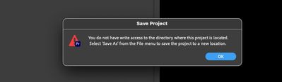

In addition,  when the editor try to save the project that she is in - writing and reading access - she reaceves this. And no one else is in that project...

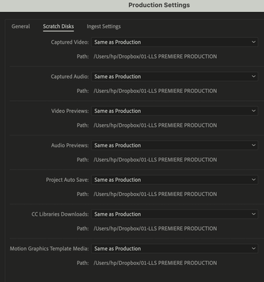

Production settings are correct on my side and editor side - all goes to dropbox.

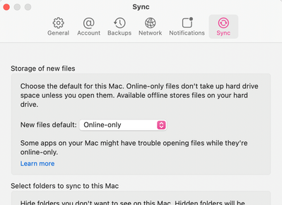

Dropbox setting is online only.

@Sedef_iari Adobe specifically recommends against working collaboratively in a production hosted in consumer file sysncing service like Dropbox, Google Drive, etc for reasons exactly like this. Productions assumes that all of the files inside (projects and the lock files) are fully there and existant. My best guess is that when you're seeing issues, Dropox has decided to host that file as only a stub on the local file system so its contents are not actually present on disk for Premiere Pro to us
Adobe Employee ,
Mar 26, 2024 Mar 26, 2024
@Sedef_iari Adobe specifically recommends against working collaboratively in a production hosted in consumer file sysncing service like Dropbox, Google Drive, etc for reasons exactly like this. Productions assumes that all of the files inside (projects and the lock files) are fully there and existant. My best guess is that when you're seeing issues, Dropox has decided to host that file as only a stub on the local file system so its contents are not actually present on disk for Premiere Pro to use.
You could try setting Dropbox to make new files default to Available offline as that is what Premiere Pro is expecting.
