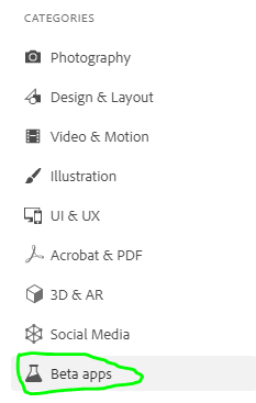

dev_willis, i saw another user that had some GPU issues as well and it seemed to be an issue with Premiere Pro. He tried to install the public beta version of Premiere Pro that you can find in the Creative Cloud app and things worked as expected in the beta version. Maybe worth trying? 🙂
Good to know:
The beta version is stable and can co-exist with the current version/s of Premiere Pro you have installed. So installing the beta version won´t do any harm to your existing installations.

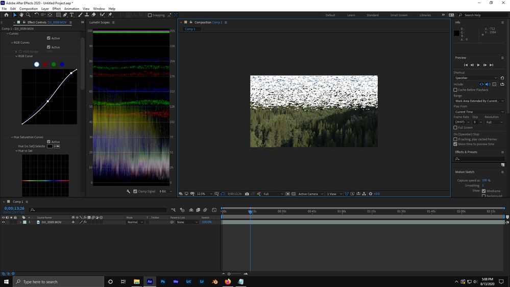

Ive got an even worse issue whilst using Lumetri Color in After Effects. More so using the curves or basically anything below that line up of control. Im beginning to think this is   yet another 2020 bug and issue. Terrible year. Okay so,.. I havent the slighest idea why it does this, hoping one can help...
My PC carries the i9-9900k, with a GTX 1080 Ti, 128gb of ram.

Which driver are you using for the GPU? That sort of thing is nearly always a driver issue.
Neil
