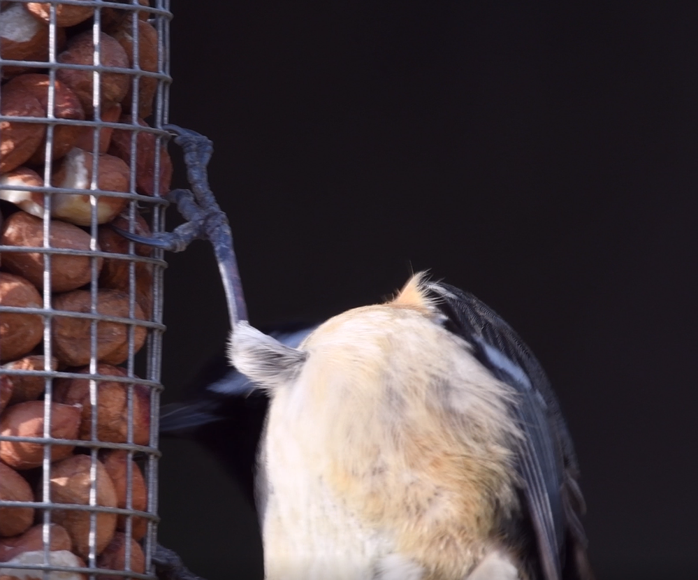

My raw footage is either from a Mavic 2 Pro (approx 100mbps, 4K, D-LOG, H265) or a Nikon D500 (approx 120mbps, 4K, Normal, H264). When exporting from Premiere pro, dark areas (e.g. water or a dark background) have very bad comrpession artefacts regardless of the bitrate I export at (obviously there are slightly fewer compression artefacts at higher bitrates), even when I have exported at the same bitrate as the original footage. I have tried this in both the H264 and the H265 CODECs. Attatched I have added files with various different export settings at H264 (note I have done nothing to the footage - e.g. no lumetri colour correction). Going downwards (40mbps, 80mbps, 120mbps, original)h264 40mbpsh264 40mbpsh264 80mbpsh264 80mbpsh264 120mbpsh264 120mbpsoriginal D500original D500
Note: for some reason uploading the photos to here has made them appear darker. If you want I can send you the originals. The original footage looks much worse than these cropped screenshots. I have seen footage with both of these cameras on youtube (which compresses the heck out of everything anyway) which look far better quality. There must be a way of exporting at the same bitrate with very minimal compression artifacts? Movie producers making blu-rays manage it.

Use the voukoder plugin, it encodes in excellent quality without artifacts.
Oct 11, 2021 Oct 11, 2021
quote
Thanks, I hope someone can help as it is very disheartening when you get great footage but you can't edit them at all as the export leads to such a great degradation in quality (compression artefacts).
By @owenl34864755
I recommend using another encoder. You can download a trial of TMPGEnc Movie Plug-in AVC for Premiere Pro and export using x.264 directly from the timeline. Fully functional and no watermarks in the trial version and with a quality that outperforms Premiere Pro´s native H.264 encoder.
Then i would:
  • Un-check Render at Maximum Depth
  • Un-check Use Maximum Render Quality
  • Set the Normal Number of Frames in GOP to 30.
