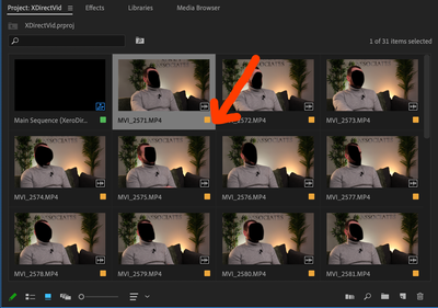

Up until the latest update, the thumbnails in the project panel showed the running time for each clip, but since the update they've been replaced with the label colours! Is there any way to get the timestamps back?

The only way I know is to switch to Freeform view, and in the hamburger menu on the project panel tab, select freeform options. There you can choose what to display in line 2 (name is the default for line1). Media duration is one choice.

This works! Shame it can't be done in icon view, but what can you do.

I just checked, as this is the second thread on this question. I didn't recall clip run times being shown.
But sure enough, back in the 2020 version, some of my clips showed run-times. I think only if they didn't have a lable assigned though.
They changed label behaviors though in 2021 and 2022 version, so I'm wondering if those changes are the reason runtimes no longer show?
