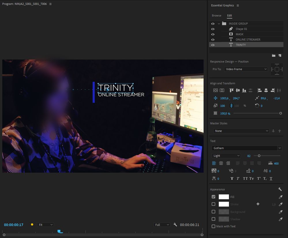

I had noticed that MOGRT doesn't like the sequence to be resized and beyond MOGRT, a simple animation of text and shapes also. It occurs even if the option " Scale motion effects proportionnaly" when changing sequence size is disable.
It's like if the option was enabled everytime and it doesn't use the anchor point of the Vector motion to move or scale the entire animation composed with multiple elements, it move the anchor points of the animated elements. This is even more noticable when you use a mask since every static element stay in place but each individual animated elements are moved away ( see the second picture ).
The strange part is that I have saved this animation after my first test from my original 1920x1080 sequence. Deleted the original animation from the 1080x3840 I had issue with and drag and drop the saved MOGRT from the Essential graphic panel. Guess what, the animation was messed up. Why ? There is no reason for that. It's like Premiere was trying to scale the motion graphic accordingly to the sequence size even if the option is not selected. And why not after all ? But why using the individual anchor points of the animated elements instead of using the scale and move properties of the Vector motion of ALL the elements ?
1920x1080 sequence with animated txt
Sequence size changed to 1080x3840

I agree that it would be much more user friendly to use Vector Motion for the resizing.
But since this is not the case, you must pay very close attention to Pinning when you create MOGRTs for different frame sizes. Pinning is what affects how the layers behave when the frame size changes.
Copy link to clipboard
Copied
Jarle (as nearly always!) has the answer.
Pinning ... and as shown in my graphic, there are several possible things to pin to ...
First, select the items you want to "pin" to something from the top list, as in this example, I selected the text line of "Debbie's New Digs". And note, you can select several items from that list or create a group.
Then to "pin" the selected item/s to one or more borders of the frame-size, you can use the odd shaped icon to the right of the "Pin To" option to select the entire frame or say as in this example, the left and right borders of the frame. You can tell as they are blue not grey.
If you don't want to pin to a border, you can also use the drop-down Pin To box to set the option you've chosen above to be "attached" ... pinned to ... an element you're selecting in the drop down box. Then if the item in the Pin To drop-down box is moved, the item you'd selected above will be moved accordingly.
And again, you can select one or more options from the top box at a time ... you can group things, and move the group ... so you have plenty of options. And I'd suggest creating something with multiple items of text and graphics at different sizes/locations, and then working the pinning options before resizing the sequence to a different proportion to see how each type of option affects movements due to proportion and size changes.

I've picked up a bit of information about this.
Premiere essentially "sees" Ae mogrts the same as video clips ... so it doesn't make any changes to them due to any resizing or framesize/proportions changes to the sequence. No more than it does for any base video clip on a sequence.
However ... mogrts created in Pr are still "seen" as comprised of their various elements, and Pr tries to "protect" those elements when size/proportion changes are made.
First, if any elements are not pinned by the user, Pr will automatically set the anchor for that element to the upper left corner. This is why things tend to pop up/left.
Second, text will automatically be resized in any shrinking of image size by frame/proportion changes in order to "protect" that text from running off the screen.
These are not necessarily the behaviors that "we" will always want. So I think a UserVoice request for an option to NOT apply auto-changes on resize would be a good thing.
And yea ... further evidence why creating mogrt in Ae is so often better than in Pr.
