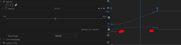

No ... after you've set the key-frame between two places with adjusted whatever, you can adjust velocity, even changing the Velocity keyframes to handle-controlled bezier, you just can't set that first ... only after setting the main motion key-frames. As below ...
It's very useful to adjust velocity against motion to get the smoothest start and finish especially to graphics via the EGP.
And notice the parameter for per-second ... yes, you can set that, and yes, you can set this then make a preset. Create one that is the speed you want, then save that as a preset ... and that should take care of your needs.
Neil

Jim, that's not actually correct ... you can't set Velocity first ... but you can set it, and change it, after you've created a main motion key-frame pair. As in my other post.
And once you've made your motions key-frame with the Velocity set as you want, you can of course save that as a preset. Which will solve the OP's problem.
Neil
