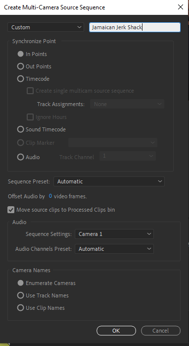

So I've used multi-cam a million times before. This is my first time on newest update. For whatever reason, The cameras will not switch. Normally if I click on the camera view that I want (while in the multi-cam viewer), It will switch the camera for me. Whether I am playing or paused, this always worked. Now, The yellow outline will not switch or select new cameras for me at all. What has changed and What went wrong?
Attached is a screen shot of how I synched the clips.Jamaican  Jerk Shack 2.PNGJamaican jerk Shack.PNG
