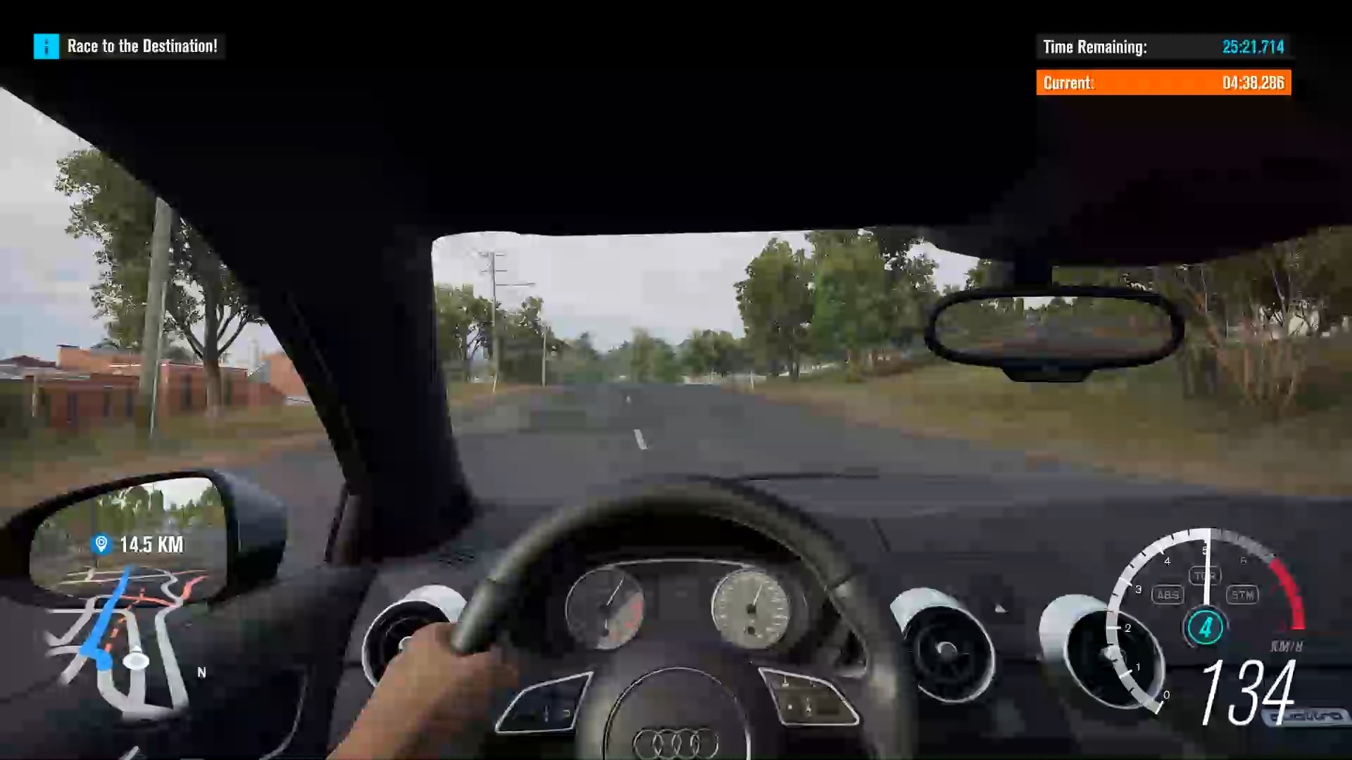

After discovering the new hardware acceleration feature I enabled the required BIOS option to allow the UHD 630 graphics to play alongside my 1080Ti, made sure the driver was up to date and found that it works perfectly with my i7-8700K. I then proceeded to render out a bunch of videos to h.264 with a 10mpbs target, enjoying the higher speed and lower CPU load. However when I checked one of the videos I noticed that the quality was extremely poor, despite only changing the hardware/software setting. I re-rendered it using software only and found that to be fine as previously, so it is the hardware accelerated rendering that is causing this. The files are the same size and are otherwise identical so this doesn't make much sense. Here are two screen grabs from the videos, I've made up a little clip in Forza Horizon 3 for demo purposes.
Software Only:
Hardware accelerated:
The difference is clear to see, very poor. As I've said these files are otherwise identical, at least as far as I can tell.

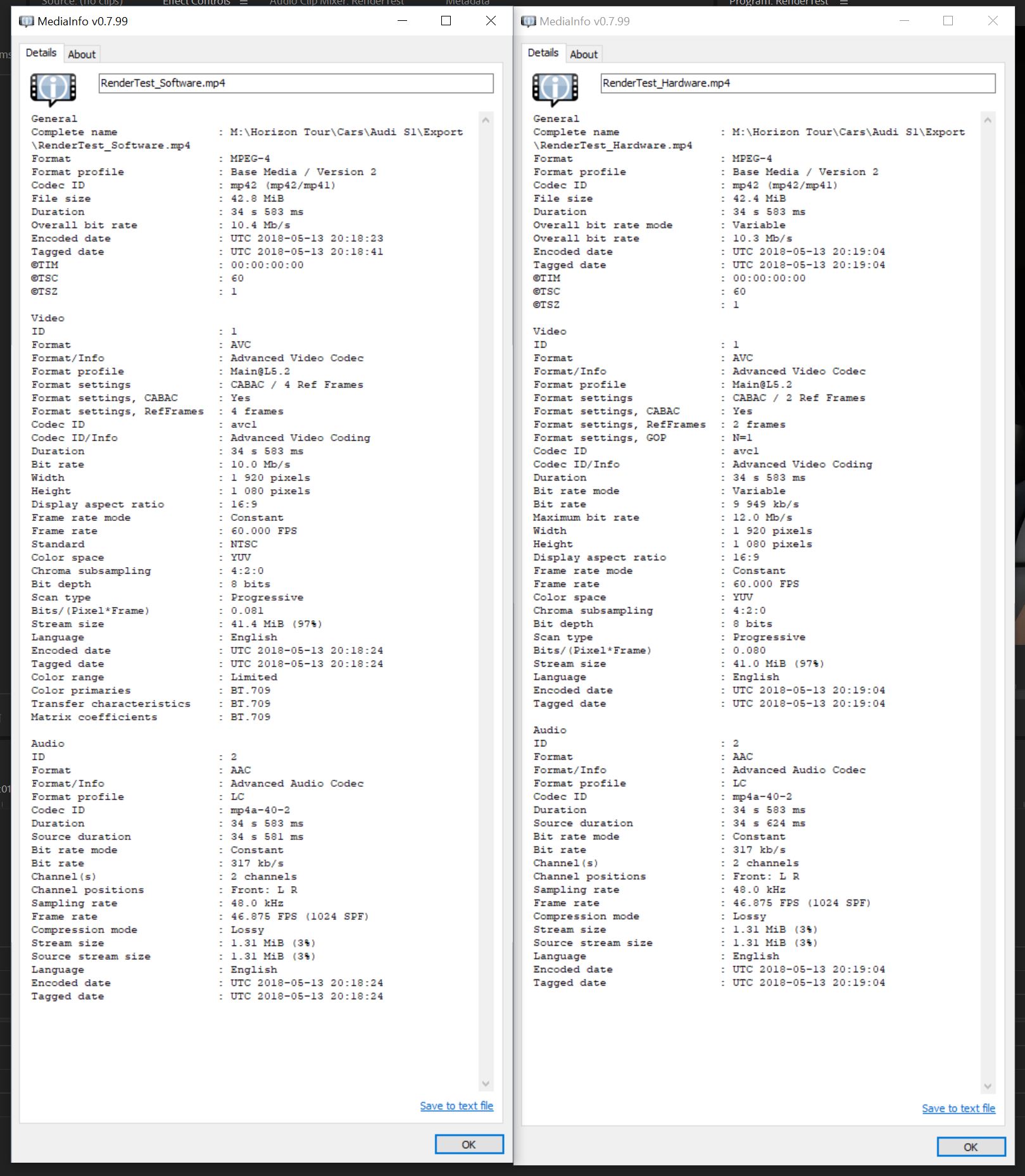

The only different output setting is the software/hardware option. It allows to set a high max bitrate but I can't see that making such a significant difference. For the sake of ensuring I bumped the hardware accelerated output up past 15mbps and it was still poor.

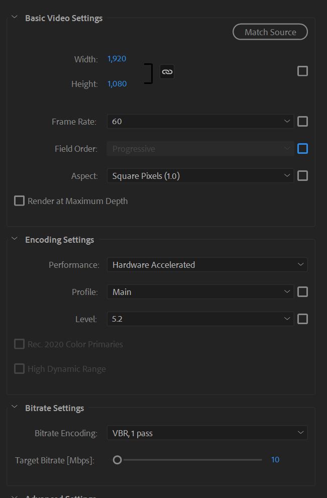

Adobe Employee ,
May 14, 2018 May 14, 2018
Hi Andy,
This feature is still under development and there are some limitations to i as of now.
One limitation I can mention looking at Matthew Tester's screenshot of Export settings that it is supported only for Level 5.1 and lower.
//Vinay

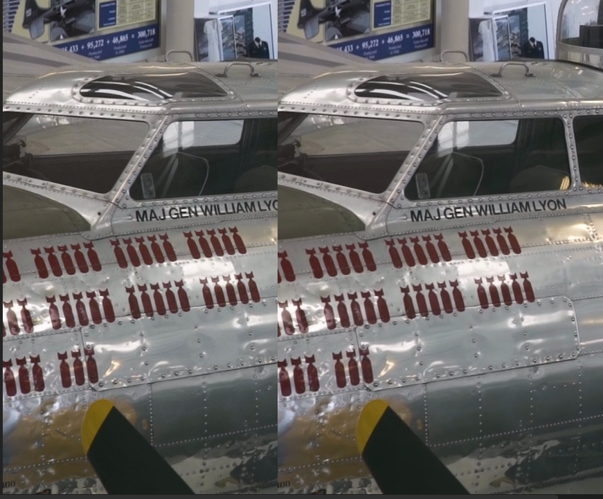

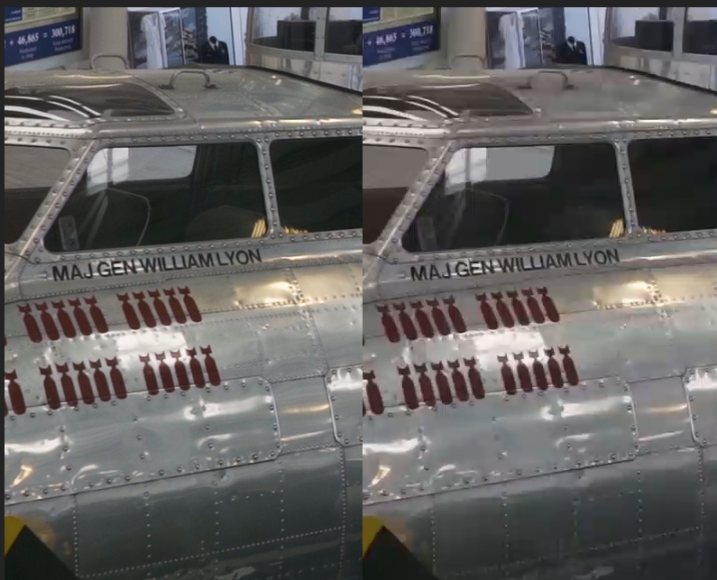

Here is some more info.  I used Profile 4.2.
What is causing the really bad quality is when I check the Key Frame box and set it to  60 (The source footage is 59.94)
    ORIGINAL                                                                      H.264 Hardware
Now, if un-check Key Frame box, the quality is very close to the original.
