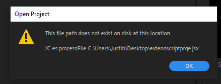

Wow, I didn't know this was even possible. Yea none of those commands are working for me either, running
"C:\Program Files\Adobe\Adobe Premiere Pro CC 2019\Adobe Premiere Pro.exe" /C es.processFile "C:\Users\Justin\Desktop\extendscriptprqe.jsx"
just throws this error:
bbb_999​ Do you have any examples on how this works and or if it does work in the current release of PPRO?

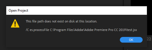

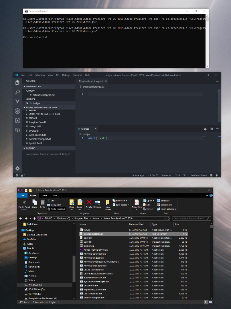

bbb_999 My mistake, realized that soon as I posted... Just updated with a .jsx
Okay, now I've got an empty extendscriptprqe.txt file and a test.jsx file in the executable directory, restarted Premiere, and still getting this error:
with command:
"C:\Program Files\Adobe\Adobe Premiere Pro CC 2019\Adobe Premiere Pro.exe" /C es.processFile "C:\Program Files\Adobe\Adobe Premiere Pro CC 2019\test.jsx"

bbb_999 Oh cool, it works when Premiere isn't already running! Assuming it can't execute on an already running instance of Premiere, does that right?

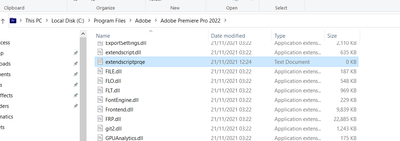

The issue is that once Premiere opens then the extendscript doesn't run and the batch script hangs until I close Premiere manually. In Premiere's preferences I switched off the home screen so Premiere automatically opens the most recent project. I don't believe the issue is with my extendscript because when run from ExtendScript Toolkit it works as expected.
Here are the steps I took:
1. Added the extendscriptprqe.txt file to the Adobe Premiere Pro 2022 directory
2. Run this batch script:
"C:\Program Files\Adobe\Adobe Premiere Pro 2022\Adobe Premiere Pro.exe" /C es.processFile "C:\Users\nickw\Dropbox (Arcus Studios)\Arcus Studios shared workspace\ARC0268 - Ta-Dahs\8) Scenefiles\After Effects\Export Edit_PREM.jsx"

I've confirmed that, with the 'extendscriptprqe.txt' file present, the following works and executes on Win11:
"C:\Program Files\Adobe\Adobe Premiere Pro 2022\Adobe Premiere Pro.exe" /C es.processFile "C:\test.jsx"

Thanks for checking that for me. I've managed to get my script to run by moving it to "C:\" and renaming it "test.jsx". It seems like Premiere is picky about special characters in the file path and file name. I renamed the file and replaced the whitespace with an underscore, which has done the trick.
