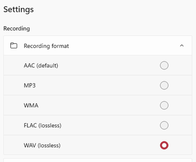

Thanks man. I actually use windows 11 'sound recorder' app to record onto pc raw, then put that audio file in Premier, and that's when the problems start. I use kinda the defualt settins in sound recorder which are attached. Do you think recording to OBS would help? Thanks for the file transfer option. Do you mean a 'raw' cut which has no cracks yet? Or a cut from Premier pro with the crackles? Thanks so much for the help! 🙂

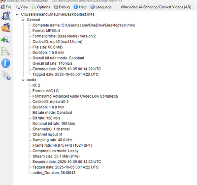

Hey mate, great thanks for all the support. Below is the grab - I hope I did it correctly. I should also mention that this is the first time I have recorded in 'WAV'. The ones that had the issues were in AAC format (default). (Please see below screen shot for example). Di you think recordin in AAC was the problem? Today I recorded my voice over in WAV, and I am attaching that metadata in MediaArea below , if you kindly don't mind having a look at. I hope that makes sense. Thanks again so much. 🙂
Community Beginner ,
Oct 18, 2025 Oct 18, 2025
Just to add to the msg below, I will attach a voice over metadata from the otherday back when I was recording with the preset AAC to see if that would affect it. Thank you so much!
