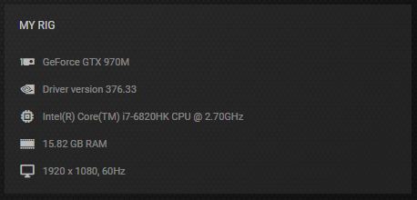

New Here ,
Dec 23, 2016 Dec 23, 2016
Hey Rameez, I've set Premiere to launch on high-performance. Thanks! I'll let you know if the problem persists. My graphics details below;

New Here ,
Jan 03, 2017 Jan 03, 2017
Rameez,
So far so good from the advice that you gave me! The flashing has stopped after I set Premiere to use the high performance GPU and made sure all drivers were updated. I'll let you know if the problem persists in the future.
