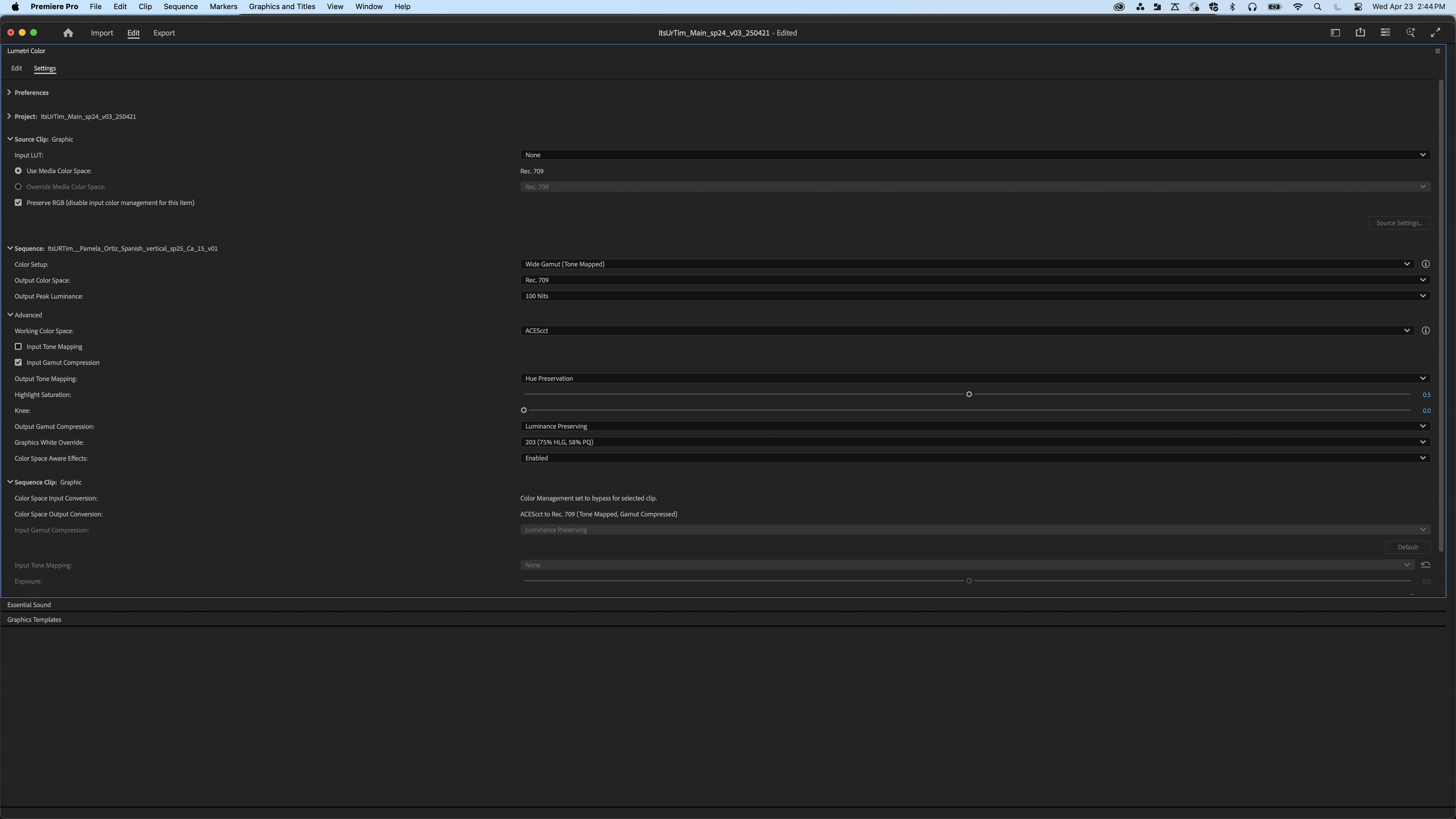

If you look at the "Sequence Clip" settings it shows that the "Color Space Input Conversion" is set to "Color Managment set to bypass for selected clip", but the "Color Space Output Conversion" is set to "ACEScct to Rec. 709 (Tone Mapped, Gamut Compressed)". How do I bypsss the Color Space Output Conversion for grahics?

The text layer created in Premiere looks greyish because you have Output Tone mapping enabled. This brings down the IRE from 100 to lower levels. Output tone mapping is a sequence-based setting, and it can’t be customized for individual clips.
On the other hand, Input tone mapping is a clip-specific adjustment that can be customized on a clip-by-clip basis.
You are currently using Wide Gamut (Tone Mapped) Color Setup for your sequence. This enables Output Tone Mapping under the Advanced tab.
That is why, in the last comment, I recommended using Direct Rec. 709 (SDR) Color Setup for your sequence, which will enable Input Tone Mapping.
Once this is done, the text layers created in Pr will have 100 IRE and look correct without any Color Space Input/Output Conversions.
Also, the HDR clips used in your sequence will have Input tone mapping applied, which can then be customized if you are not satisfied with the default settings.
Using this method, you can start with a default Input tone mapping and customize it for individual HDR clips by selecting them in the timeline and making adjustments under Lumetri Color panel > Settings > Sequence Clip > Input Tone Mapping. Please see the attached screenshot for reference.
Also, please note that Preserve RGB disables the automatic input to working color space conversion but does not affect the working to output color space conversion in a sequence. That’s why you need to manually disable Output tone Mapping if you want it to not affect all the clips.
I hope this clarifies how the color management options work. Please refer to this article for a detailed explanation of the color management options. Let us know if you have any questions.
