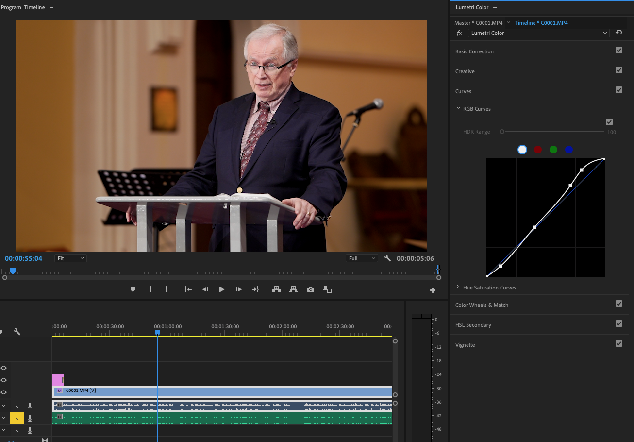

Hi Caroline
Here's some screenshots!
Here's one with the curves applied.

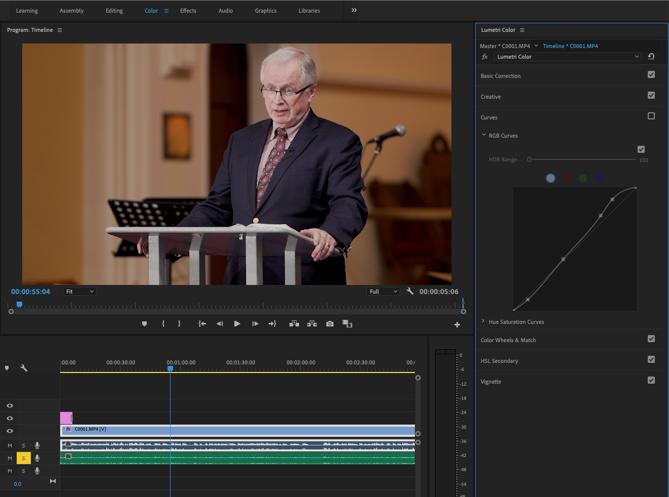

Here's one with the curves deactivated.

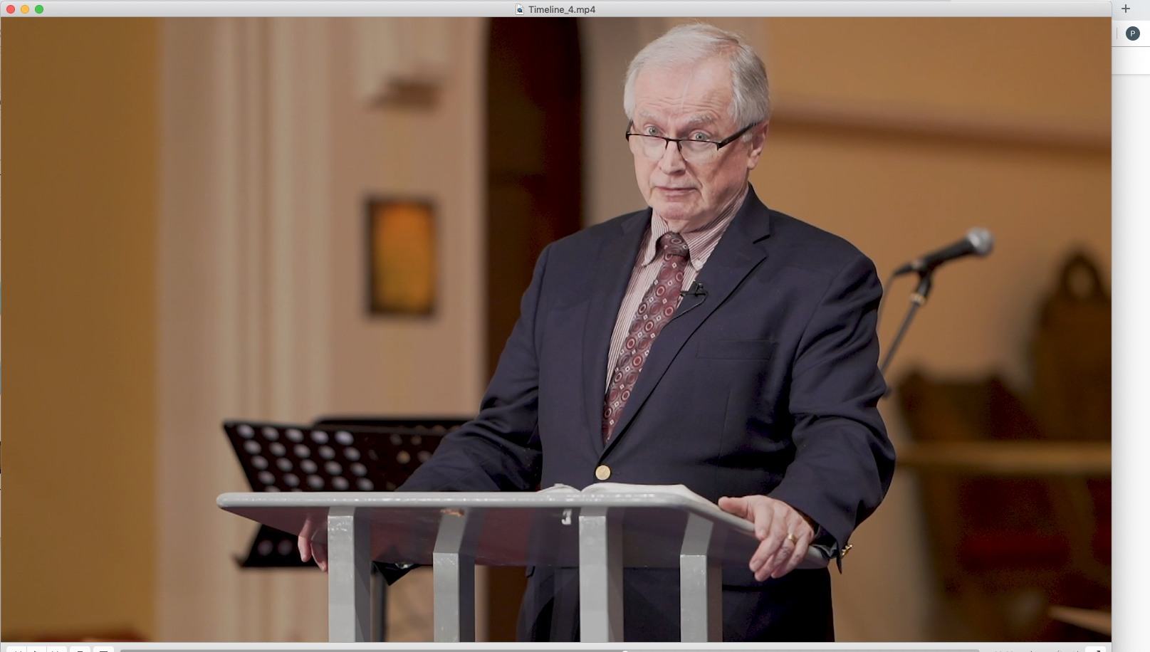

This is the footage exported.
I've tried exporting it with curves turned on and off and it doesn't affect the exported video.

Are you perchance on a Mac with a P3 monitor set to the base P3 color space?

You may be right.  My point is that you should start with a proper reference.  Until you do, there may be hidden variables at work.

Your curves as applied here are basically exactly what the P3 monitor space does in reverse to the media ... so ... especially when viewed in the notoriously color stupid QuickTime player ... your work is canceled by your viewing system.
Pr simply does NOT do anything wrong with processing of your pixels. You are not using an appropriate setup to view sRGB/Rec.709 media as sRGB/Rec.709 on the screen.
Within the Mac OS settings for color space, there is an option for Rec.709. Try that.
