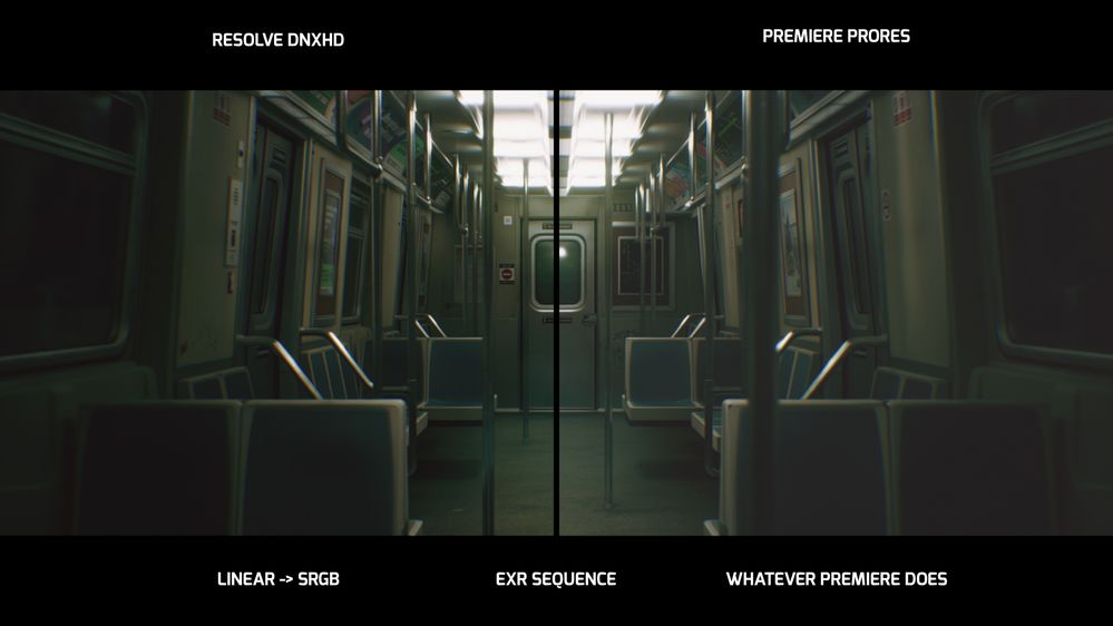

* To clarify - performance is not the issue with Premiere - just the render results. Comparisons set up in After Effects.
We're rendering testing from Unreal Engine to these DCCs. First tests were with PNG sequences imported into both and exported as Prores from Premiere and DNxHD from Resolve and there were no differences between Resolve and Premiere results. All good so far.
After this we tried EXR renders from Unreal and this is where Premiere's issues started, because of the weird way it color manages things.
Comparing the Resolve and Premiere versions (when you bypass the linear converter in Premiere) looks the same.
So you can see that both DCCs sees the same "raw" EXR files.
In Resolve, it's a quick change the working LUT to Linear -> sRGB and it's done. Resolve results are good again. In Premiere, when you uncheck the "bypass linear conversion", results are washed out

If you switch the Color management OFF, results are closer, but still darker than Resolve
And here's a comparison between Premiere differences witht he render when the Color management is ON vs OFF

The open EXR files apparently haven't been added to the formats recognized by Premiere's new CM system. That would be why the CM sections in the Interpret Footage section are grayed out. @Fergus Kousha would be the person I'd ask about that.
From the examples, I see very little difference in the one that you have Resolve and Premiere side by side, labeled "and whatever Premiere does" ... the Premiere one does look a bit lighter in the darker values, but only a small amount.
So I'm perhaps not seeing the major difference you are somehow.

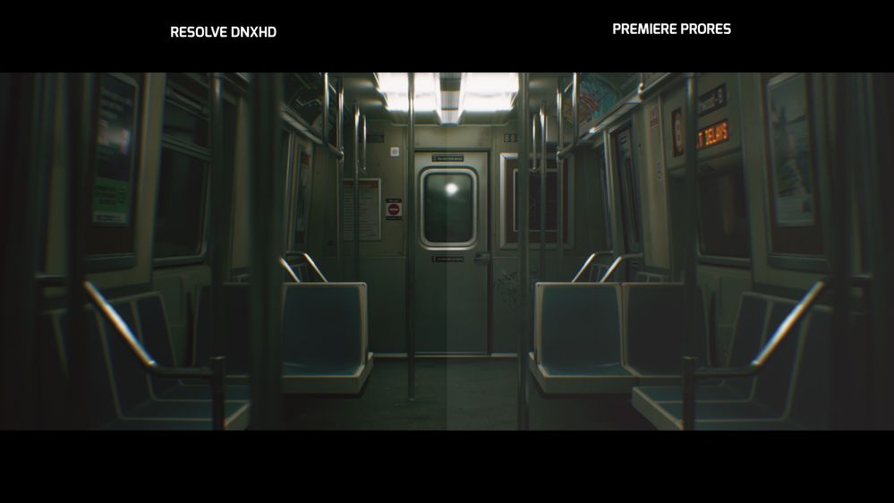

Thanks for the detailed answer. Really appreciated. I'm adding two more screengrabs from the renders, to hopefully help show the differences between the Resolve and Premiere renders.
In this one, you can see the difference quite clearly.
It seems that whatever is happening with the Premiere CM, its clamping the result more than just a straight Linear to SRGB conversion. You can see in the black levels, obviously, but also the lights, you can see more details in the Premiere version.
I removed the separation line, so you can the two next to each other better.
For After Effects, no added CM. Working space is set to none and I just added the color profile converter effect, like so:

Is this screengrab within Ae or from an export from Ae? Are all these from exports, not from what the image looks like in the app? Does what the image looks like within the app matter to this question?
I'm trying to get at exactly the main element of the query.

The screengrabs are from the RENDERED footage from Resolve, Premiere and After Effects. So the results are the same with the Premiere renders being washed out, whether I compare them in Photoshop, Quicktime, VLC, Resolve, Premiere itself or After Effects. The resultant renders from Premiere is washed. SO no it's not a ful vs video levels thing.
And yes, After Effects absolutely converts it correctly. All this needs is a straight Linear -> sRGB conversion. ALL other DCCs give me the option to do this.  Nuke as well. Premiere can't so this
So no, I'm not gonna argue what is "correct" according to your answer. Premiere is simply not doing what it is supposed to. The result is wrong.
And my colorist friends who trusts the Resolve result above anything from Adobe agrees that After Effects looks correct here, while Premiere does not.
You are trying to make straw-man agruments for why Premiere can't do a simple color profile conversion, and honestly this isn't helping.

Second ... looking at the differences between the Premiere render and the Resolve one, that does look very much like the difference I've seen with troubles between video/full settings from what I can see on my monitor.
Which is why I brought that possiblility up, because it does seem a possibility to me still. That Premiere is treating the values differently than Resolve or Ae somehow is pretty obvious. It looks from my monitor like slightly lifted blacks and slightly lowered white point. (And I'm not on my main system with the fully calibrated feed out.)

Also, wondering if this is simply a full vs video levels issue.
In the Presets bin there are included Lumetri presets for legal to full and full to legal range.
I'm wondering what the Premiere one would be with the legal to full applied?
