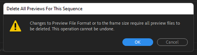

Thanks, Neil.  I found it.  I'll now try to figure out exactly what it does.  I did it for one of the video clips and it worked fine.  The Sequence was HD, like you said.  I tried another and it wrote over the first.....?  I'll keep at it.  Also, your very first post trying to help, you suggested I check the Sequence Settings.  Whenever I did that, it was greyed out, so I could not check anything.  Then much later I finally discovered that you have to have the Time Line selected for it to be active.  I saw, indeed that the video was set to a much smaller size.  I changed it to 1920 x 1080, but got the warning that the imported video clips were going to be erased.....?  I did it anyway and it helped a great deal.  But not sure what happened to those clips.  This all seems insane to me as I thought I had a pretty good work flow in my previous projects.  Did they change something?  Time for wine.  Pretty frustrated.  Thanks again for the help.
By @frederickb55734382
You must have read wrong. Imported footage is never deleted when you change those settings, or any other setting.
What the message told you were that the preview files will be deleted. Those files are created if you manually renders the timeline as in Sequence > Render Effects In to Out/Render In to Out/Render Selection/Etc, etc. Those files can be re-created so if you do delete them it´s no problem. Most of the times one can edit from input to output without ever needing to render the timeline.
