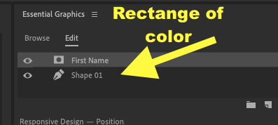

Yes, as I said in my first post, it only works on elements contained within the Essential Graphic. Your graphic only has type. You click on mask with text and there is nothing for the text to mask - so you get nothing displayed.
In your graphic add another layer - like a square of color - beneath the text, as I showed in my example.
Then you will see the text cutting a mask:
You are working with the text graphic and an element outside the graphic itself - the video clip. In order for that text to b

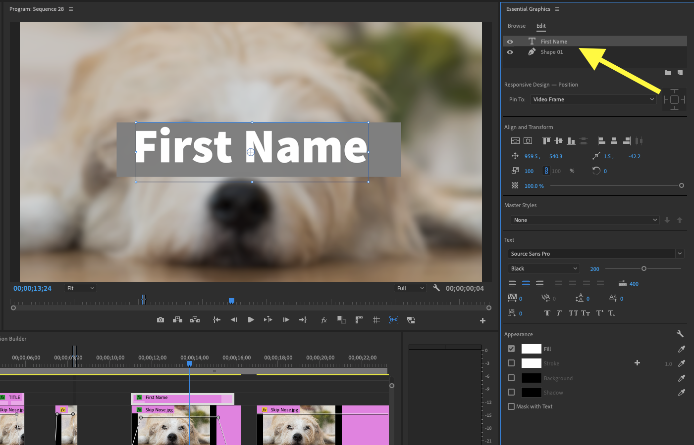

"Mask with Text" in Essential Graphics works only on elements contained within the graphic itself, such as this example that has text over a gray bar:
If i select the text layer and check Mask with Text, it works:
To do what you want, you must use the Track Matte effect.

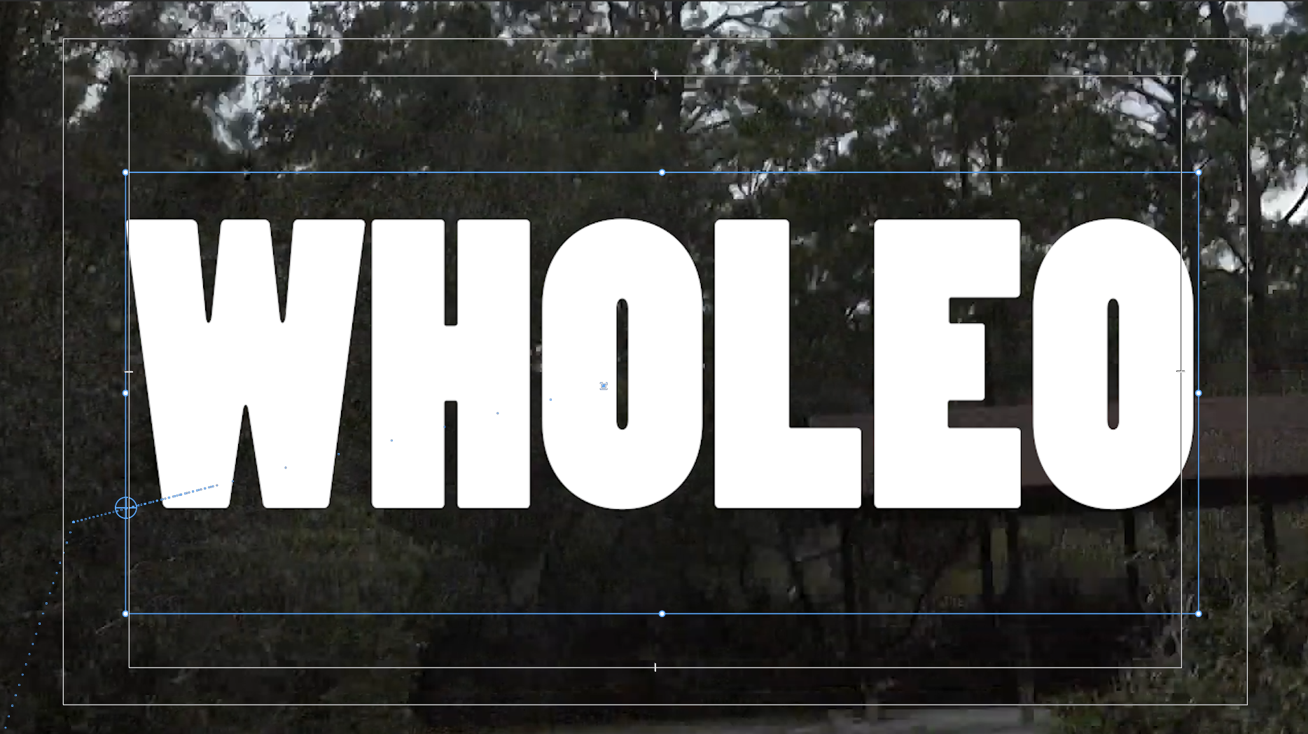

Text layer over video layer
Click "Mask with text" box on text source and it goes invisible.
Follow The Sand, a 5-year movie plan: Wholeo 2024
LEGEND ,
Apr 27, 2019 Apr 27, 2019
You are working with the text graphic and an element outside the graphic itself - the video clip. In order for that text to be used as a mask for that video, you need to use the Track Matte Key effect, applied to the video clip and with the text clip chosen as the source for the matte.
