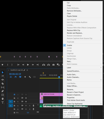

Hi All,
I am doing a project in Premiere Pro CC but need to dynamic link to After Effects CC.  The "replace with After Effects Composition" button is greyed out and I can't understand why, both are installed!
I still have Premiere Pro CS6 and AE CS6 installed, because they contain plug-ins I use regularly, could this be causing an issue? I can't think why it would.
Any help would be greatly appreciated.
Many thanks,
Rick

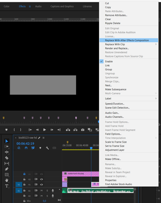

Hi, I don't know if that's your case, but I discovered that you can't use Replace with After Effects composition unless you have some visual media - it doesn't work when you have audio only in Premiere Pro. But if  you add something, e.g. a simple rectangle, suddenly this option is available. It's not very convenient and creates unnecessary compositions within AE project, but it works.
