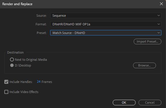

Select one or more clips in the timeline panel on the sequence. Right-click to get the context menu.
Guide ,
Jun 21, 2023 Jun 21, 2023
Ok, Here is the Screen-Shot. Righ click-Render and Replace.
Render and Replace.jpgSo Technically if I do This, I don't need to use the Export option.
LEGEND ,
It's not the same as an export. This creates new individual clips to replace the ones on the sequence. Not a complete single export.
