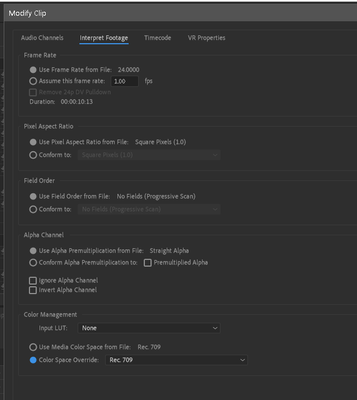

Details on one of my clips (which was used to create the matching sequence)
Thanks for your expertise.

Also, I changed the clips to rec 709 but Rec 709 is not an option for me in the sequence properties.
even if i create a new sequence from one of the interpreted clips it doesn't select rec 709
This is a bit over my head. I don't really understand the nuiances of the color spaces and what's compatible with what.
