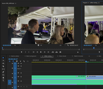

I am trying to replace in my timeline an MP4 version of a duplicate MOV clip.  Currently, when I try to do this, I click on the clip from the timeline so that it shows in the Program monitor, and I try to find the timestamp for when that clip starts (so that I can match it with the start of the new MP4 clip in the Source monitor), but I only see the timestamp relative to its place in the timeline.
How can I see the timestamp for a portion of a clip that has been used in the timeline?
What do you suggest as an alternate method, if any?

Ok, there are several ways to do that.
1. If your MOV and MP4 have the same duration and timecodes, the easiest way is to replace the clip from the bin (project panel). Locate the MOV in the project panel, right click > replace footage, and locate the MP4. All the MOV instances used in the timeline will be replaced with the MP4.
2. To reply to your specific question, in order to view the timecode of a certain clip on your timeline, you have two options.
     2.a. Right click on your program monit
     2.a. Right click on your program monitor and check "Overlays", this will display a small box on your monitor with the timecodes specific for each track.
     2.b. If you find those Overlays intrusive, you can go to window > timecode, this will open a new panel where you can add lines to display any timecode related thingy.
Hope this helps.
