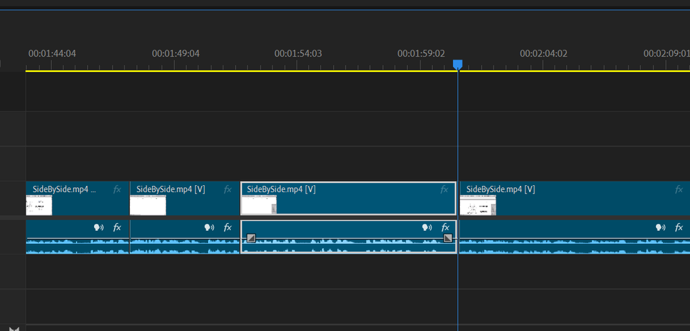

People's Champ ,
Oct 08, 2024 Oct 08, 2024
I'm not sure if it helped. I think you're describing a situ in which the delete simply doesn't affect all tracks.
The case I'm describing is that it is affecting everything, but it's not making a "clean" cut, and not actually closing all the gaps properly (i.e. not rippling perfectly).
In the following sequence, we see: (1) In and Out points set, ready to Extract.
(2) Just after clicking on Extract. Looks okay from a distance.
(3) But zoomed in, you see that in fact both the audio (I didn't realize this initially) and the video have not completely rippled, i.e., there is a distinct gap both in the audio and video tracks.

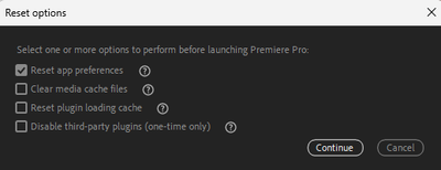

That result is not normal. One thing that caught my attention is that the blue "bar" that normally point to the right points mostly to the left and some of it point to the right on you screen dump. On my screen dump below you can see how it should look.
When Premiere Pro behaves odd the best way to fix it is to reset the preferences. Close Premiere Pro and then launch Premiere Pro while holding down the Alt-key. This should give you the Reset options dialog.
