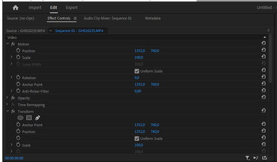

But may I ask, pls see below - in the video there is already a rotation option but that didn't do the tick, what's the difference?

Some effects work on original clip and ignore the "Motion" in effects control panel, so adding the "Transform" effect solves that problem

There is an order or operations when it comes to Effects.
It's the same reason why if you apply Timecode and then Transform (or flip) you will get one result and if you reverse the order and say apply Transform and then Timecode you will get a different result.
In general Effects apply in order from top down and they affect not only the source clip but also each other.
