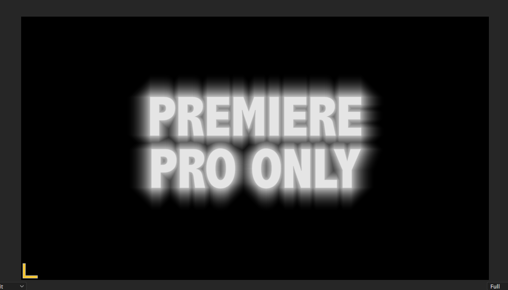

In Premiere Pro you can do a glow effect on the text with Effects > Video Effects > Stylize > Alpha Glow:

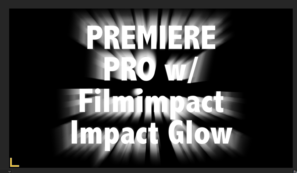

Or you can add a 3rd party plug in like Filmimpact Impact Glow ($$) https://www.filmimpact.net/​     :
