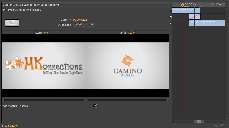

Open the problem transition in the Effect Controls with timeline view and make a screendump and post it here on the forum.
Copy link to clipboard
Copied
Is this what you need?

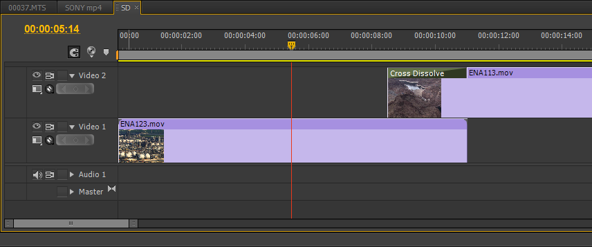

Place your clips in the same Vidoe track.'
Seems like you might have A / B'd them ....but a Timeline grab would show us.

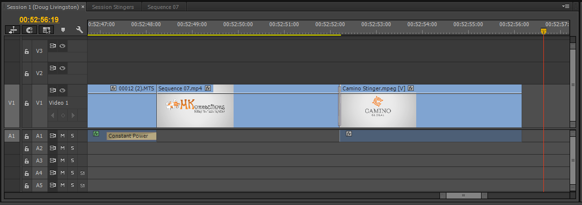

I put them in the same track, but perhaps I did it incorrectly? Here is my timeline; as you can see there is a tiny little transition (2 frames long I believe) between the last two clips.

Ok, this helped me understand a little. I left off only one frame on the beginning and end for the handles, so that explains why my transition was so small. I increased the dead-space, which instantly allowed me to do more with my transition. Thanks for the help! I'll be able to put that knowledge to good use now.

As shooternz (I think) meant by A / B would be having the two clips
on different tracks... if you do that, the idea of needing 'handles' for your
transitions is more visibly apparent.

I have confirmed that I have handles
It would seem they're not long enough. You need half the desired transition duration for each clip.
