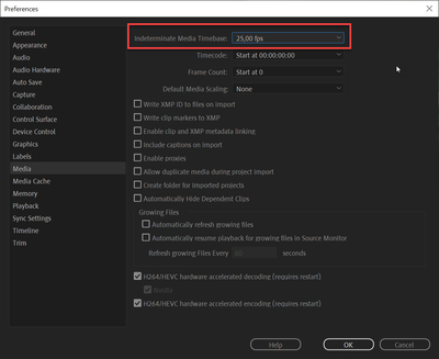

Dont forget to set
to desired framerate.
Default transition duration is not stuck at 2 frames it is the minimum requirement to set a double sided transition.

How exactly does Intermediate Media Timebase affect this?
In general, I've had a hard time getting clear answers to anything about timing in Premiere Pro.  Out there on the web there's a lot of "folk culture" about things like this ("try this", "try that"), but there's no reason why it shouldn't be mathematically deterministic:  If I have a set of still frames that I want to render at a precise rate (so they match a musical beat) it should be straightforward to compute the settings based on fps, still-duration, transition duration, timebase, etc.   Where can I get some precise information on this?
Votes
Mar 04, 2023 Mar 04, 2023
Copy link to clipboard
Copied
Still images don't have a framerate just a duration.
In video 1 frame is the limit.
In audio you can go as far as 1/48000 of a second.
the higher you set your sequence framerate the smaller 1 frame in time gets and the more accurate you can edit to the beat.
Sorry Intermediate Media Timebase is for still image sequences only (it sets the timebase).
