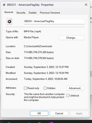

The file that they send is a .crdownload file
The American Flag is size: 393 MB (412,208,442 bytes)

I screenshot the file it appears to be a MP4.

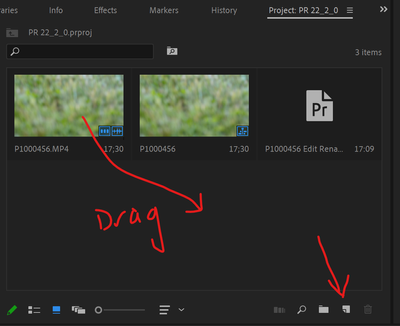

1 - Import to PR the American flag.mp4 movie that they sent you. (That will put it in the project panel.)
2 - Drag it to the "new" icon in the bottom right of the Project Panel. (This creates a sequence that matches their file.)

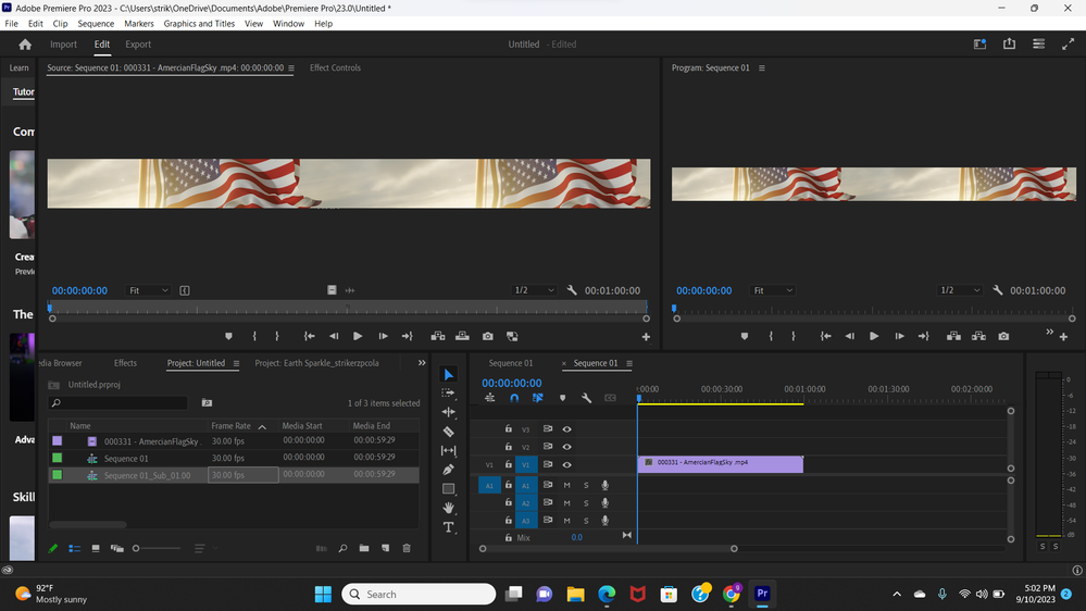

I imported the American Flag file. I am not sure about your step #2. I do not know where the "new" icon is or where  to drag it. After I imported I then clicked to export it & took a screenshot. I am not sure if this is what you were wanting since I didn't complete step#2.Export Screenshot.png
Sep 10, 2023 Sep 10, 2023
The "one they sent you" in step one will be 10880x448. Is that what it shows in PR properties?

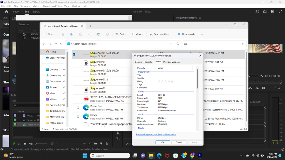

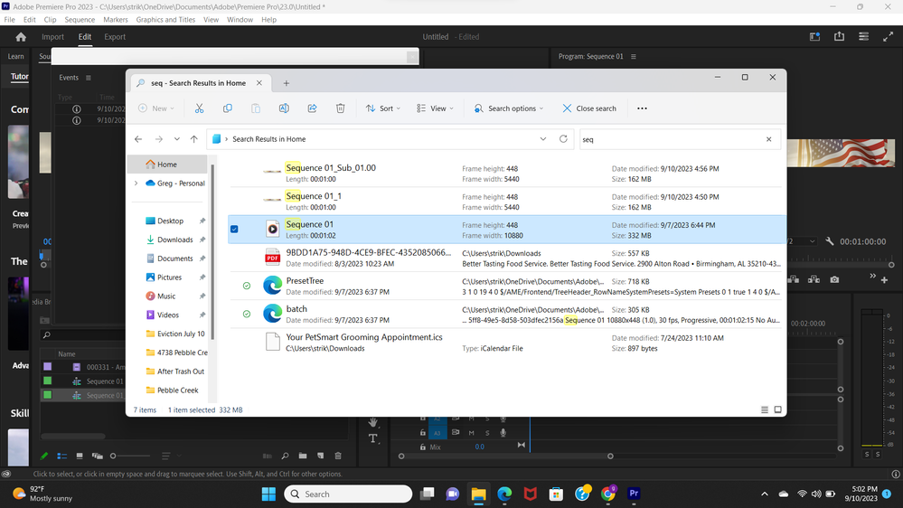

Hi Stan, I am still unsure if I am seeing what you are wanting me to see. I dragged it to the new file that you pointed at. I am not sure where to see what it says in PR properties specifically but I took screenshots of some of the details. Not sure if any of it is helpful. Sorry!Screenshot 2023-09-10 170216.pngScreenshot 2023-09-10 170242.pngScreenshot 2023-09-10 170259.png
The screenshots seem contradictory. You have a sequence that says it is 10880x448, but it doesn't look that way in the PR screenshot.
In your Project Panel, click on the 3 lines (a "hamburger" menu) and pick Preview Area. Then when you click on something, it will tell you the pixel size. You can also right-click an item in the Project Panel and pick Properties.
