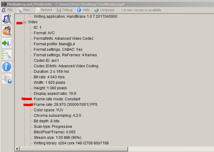

I am going to take a guess here: could it be that your footage your camera is shooting is shot in a variable frame rate? because if it does, premiere does not like it. you should drag you footage into mediainfo and check
see if it says constant in this tree:
if it does not, you will need to transcode your video first through a software that converts variable frame rate to constant. see this here thread: Re: Alternatives to Handbrake?  Handbrake not converting Variable to Constant Like it used to

It shouldn't be a variable frame rate... it's been shot on 25fps but maybe it has a problem with transfering it to the SD card.
The example screen capture I made is variable, that's because i captured it with Quicktime and it couldn't handle capturing while playing the video in Premiere. So you shouldn't use the example video to determine that i guess...
is there a mac version to check for contstant/variable fps? Or is it possible my SD card or the camera itself is something wrong with?
LEGEND ,
May 09, 2017 May 09, 2017
MediaInfo - Download
