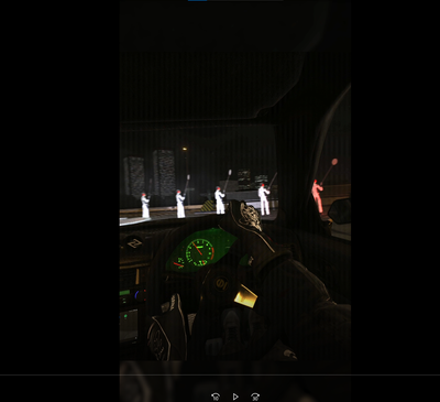

Vertical lines appear while playing the video in premiere and when I export the video the lines increase. But when it is paused you don't see those lines. The recording is fine.

I've removed the gamma effect, and now they are squares jajaja.

I have found that if I turn on high quality playback, the lines disappear in the preview. But when I export, the lines still appear.
