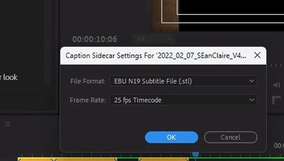

Community Beginner ,
Feb 08, 2025 Feb 08, 2025
Well it tutns out I just found the solution from within premiere 24.  I was initially lookingfor the .stl options from the text window / export area and then also on video file export options as you were, but found that it is acuall via File(main menu) / Export / Captions and then you have multiple selections of the CC export  - including .stl  🙂 as per screenshots below.  You get the full host of metadata and checkboxes options to fill in also(which would not be available if using an online .srt to .stl converter).  Hope that helps someone going forward.
