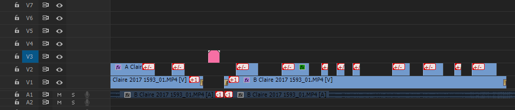

I would sync the two cameras first, often a stills camera flash is a good sync point but you should not have two many problems matching the pictures. I would then sync the sound to the pictures, you will have to do this by eye. I never use the multicamera option in Premiere just put you master wide (if you have one) shot on V1 put the closer shot on V2 and just cut out the sections on V2 that don't work (reframes, out of focus etc.). This is a sample of a dance  show timeline shot with two cameras giving you some idea.
