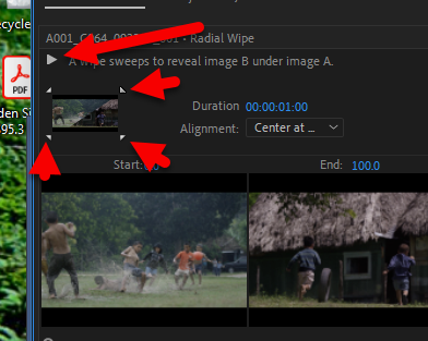

You can control where the wipe start using the 4 little arrows up above the setting when using the Effects Control Panel, with the wipe selected. Use the slightly bigger play button and you can select each option and see it on that tiny display.
