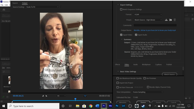

whenever I make a vertical video I usually get a fat green bar when I try and upload it to tiktok or snapchat or Instagram.
Not sure if it is because it is vertical but this is very annoying and I was wondering if any of you have a solution to this.
its always a green bar on the right side.

Post screenshot export settings with left tab to output with an image (not black).

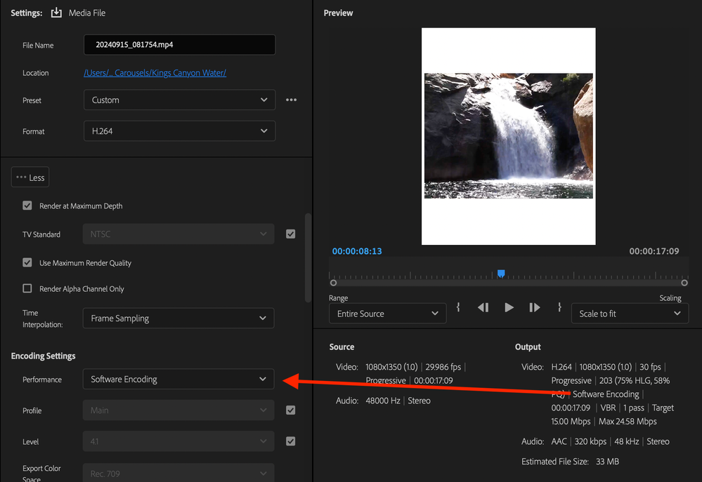

After searhcing through out the web for the same reason I found this post. Four years later and the encode update worked for me.  Thanks!
My case I would also see a green line at the bottom of my videos after uploading to Instagram, switching from Hardware Encoding to Software encoding worked!
