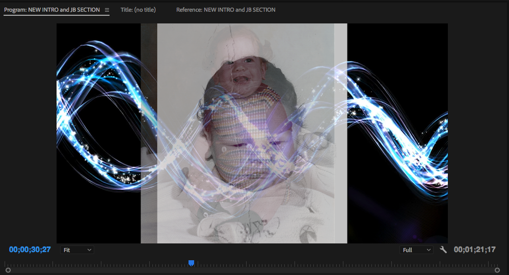

I have the video in V1 and the photos in V2 and V3.  When the photo transitions from Photo 1 to Photo 2 you can see the background video bleed though during the transition.
I'm totally new to all this so I may not be describing it properly so I've attached a screen shotSnip20171201_1.png

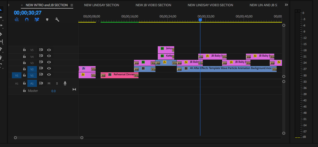

Please post a screenshot of your timeline.
New Here ,
Dec 01, 2017 Dec 01, 2017
One way:
Move v3 and v4 to v4 and v5.
Put black video on v3 the duration of the transition and crop it to the size of the photos so that it covers that part of the background that is bleeding through.

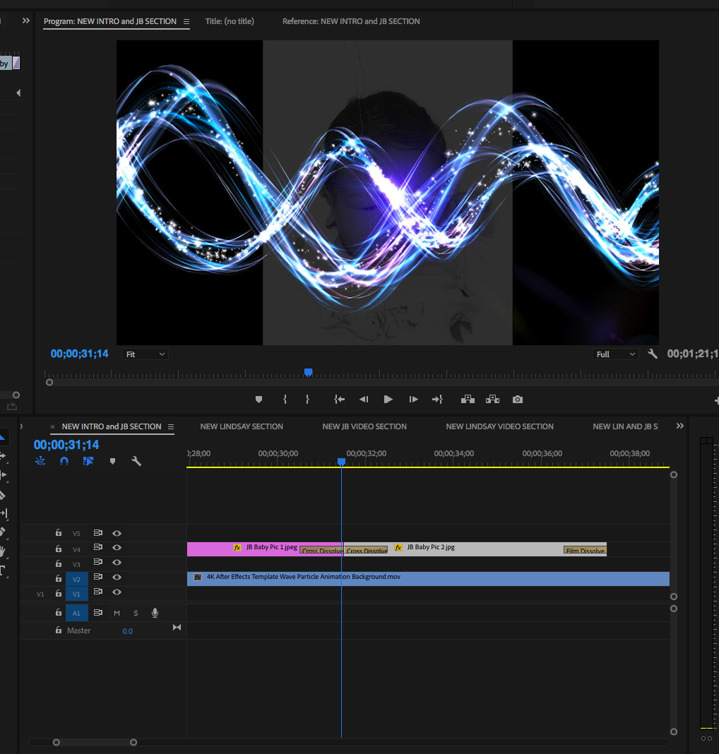

If you use the transition like this (double sided) you wont have the issue.
New Here ,
Thank you for the suggestion but the background video continues to break through
New Here ,
NEVER MIND!!  I see how you did it after looking again and it totally worked!!

That screenshot helps out a lot, thank you for posting that.
What is happening is that with the film transition it is dropping the opacity of the first photo and brining up the opacity of the other. Because of that there are times when the opacity are so low that the background bleeds through.
