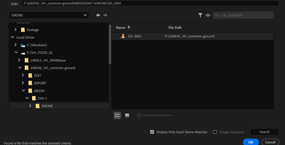

They are offline because Prem won't link them. Hence, they are offline.
When I open the project, it starts looking for files. It finds a few jpegs and mov files. Then, it says that it can't find these files, which are MP4 (HEVC) 10-bit files.
I go and search for them. It finds the files and I click OK:
but then I get this message:
I click cancel and offline all as it doesn't get me past this and it shows the timeline with the files being offline.

When I go to find the file (as it says it’s missing as its looking at another location), I get this:

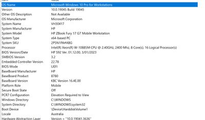

  • System Info: CPU, GPU, RAM, HD:
    • CPU
    • GPU (Intel-based Macs and PCs)
    • GPU driver (PC)
    • RAM
    • Hard Drive (and, if external, how the drive is connected: USB 3, Thunderbolt, NAS, etc.).
  • Video format: Provide information about the type of video you're using. For example, XAVC-I 4:2:2 10-bit. If you're unsure, let us know what settings you selected on the camera. Sharing a sample file is useful if you don't have access to the camera.
