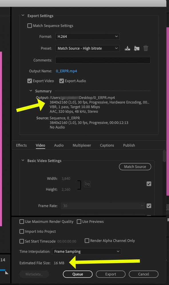

Aug 06, 2020 Aug 06, 2020
A 1920 by 1080 12.5 second export at 10Mbps gives and estimate of 16MB :
Same file exporting at 3840 x 2160 at the same 10Mps, same end file size:

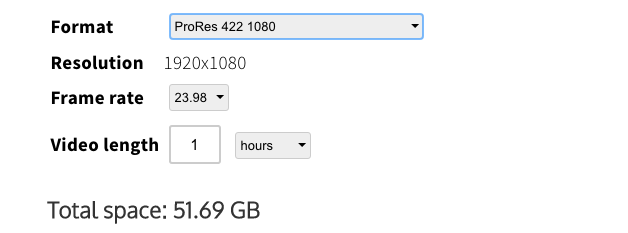

we're NOT talking h264, we're talking prores.  as per digital rebellion's video space calculatorScreen Shot 2020-08-06 at 11.09.42 PM.pngScreen Shot 2020-08-06 at 11.09.29 PM.png

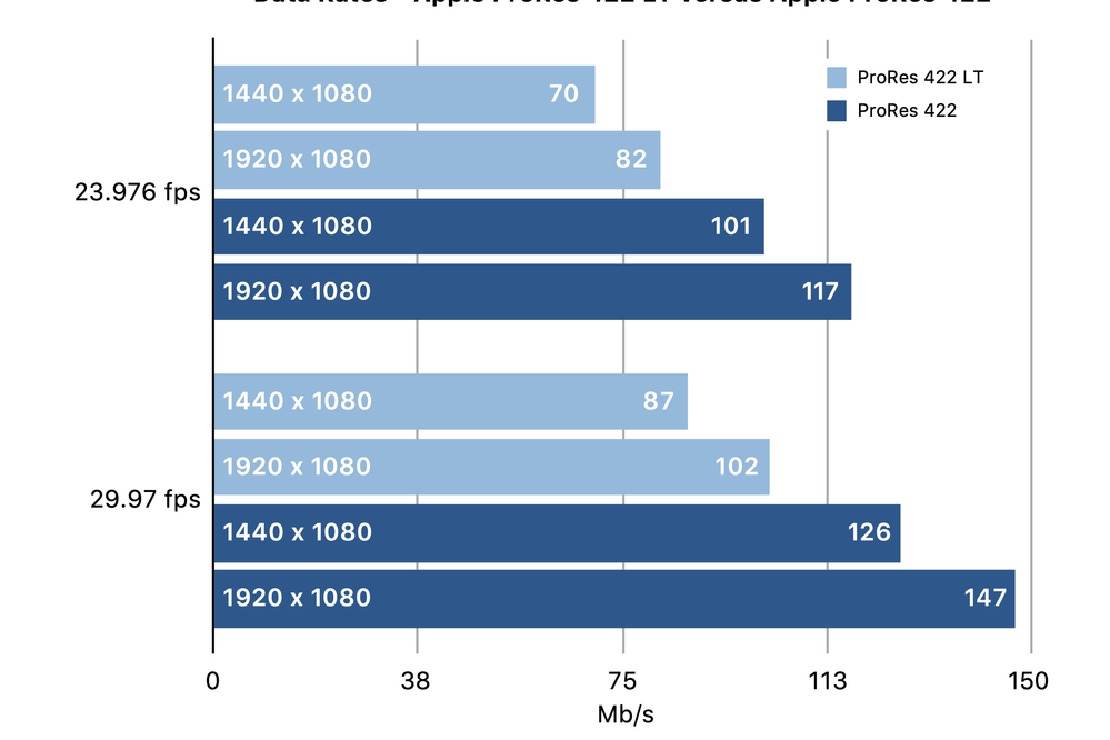

Which is becuase ProRes has specific bitrates for specific frame dimensions:
which is a specific property of Apple ProRes. So by changing the frame size,  ProRes changes the bitrate as well to produce the smaller file size.
