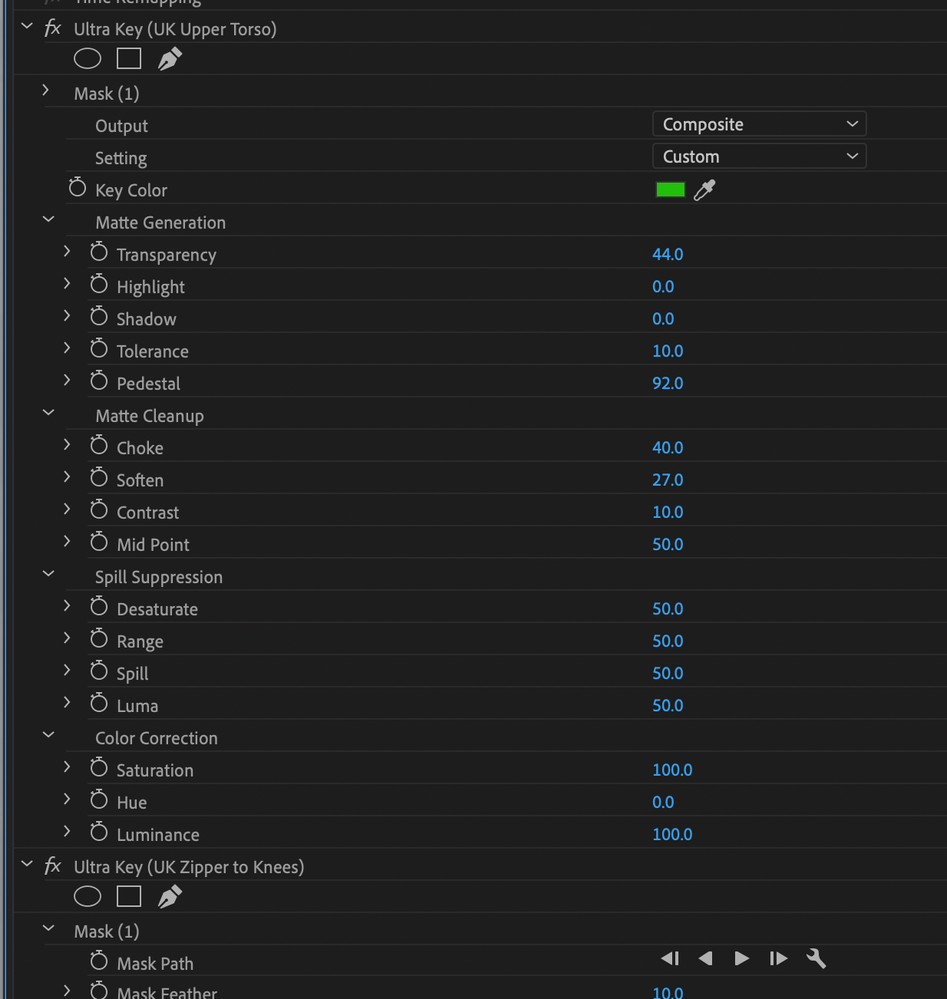

Here are the settings for the upper torso, sorry to say no magic here:

May 13, 2020 May 13, 2020
Meg,
Thanks for screenshot, you have a very different options indeed in Matte Generation and Matte Cleanup section than mine, so I see why the difference 🙂 And thanks for the link to tutorial, I will definitely check it out tomorrow, although I do prefer to do all my work in Premiere (and nowadays you can do A LOT inside Premiere directly, which is good :)) with going to AE when absolutely necessary.
