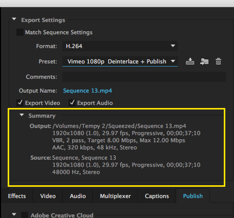

Please post a screen shot of your (typical) export settings summary, like this example below:

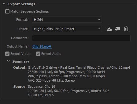

Below are two images, the first one is of a project I completed just a few days ago. The second image shows the export settings of a project I worked on before this issue became apparent.

Your clips are VFR, variable framerate. Look at the fps numbers of the clips.
Those are done by phones and other devices trying to save on data writing to chip by only recording the number of frames they think necessary to have an acceptable viewing.
The first one, your sequence was made from a clip PrPro saw as basically averaging 30.299 fps, and you exported at 60fps.
The second was a sequence at 58.09 fps exported at 60fps.
I think you need to learn how to get a basic framerate out of your device, interpret that as something normally used for fps like 30 or 60, then export to match.
