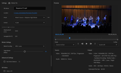

These are the export settings (some of them, sorry I don't have Mediainfo)
80 KB??!  How does a 3.06 GB file turn into 80 KB without trimming?

Forget about the filesize.
make sure you export the entire sequence and not just in to out (screenshot shows 1 frame).

oh goodness, you are right. This was just one frame in the screenshot. That explains the 80 KB. But when I first asked this question it was because my export file size was about 621 MB with the settings matching the source. The original video file is 3.06 GB.  The only difference I could find was the bitrate.  But even with that at 50 Mbps the file size was about half of the 3.06 GB original. I will attach  new screenshots.
