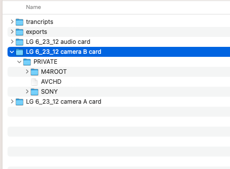

Thanks Warren, The proxies are all in a folder named I'm thinking of spending a day moving the proxy folders to a a folder and adding the name of the "source" to the each individual proxy folder.  And then attaching the proxies for each "source."  Then just moving that folder to the portable drive where it will be simple to match the folder structure of the path to the proxies on the raid...   Feels a little more foolproof (me being the fool)...  I've attached a couple of screen grabs to illustrate the current situation (although this is on a project I'm cutting, not the big docScreenshot 2023-07-06 at 4.32.16 PM.pngScreenshot 2023-07-06 at 4.31.38 PM.png
So I'll simply rename the "proxies".  folder to "LG 6_23_12 camera B card proxies" (copying the folder name to avoid "operator error" and then move the renamed folder to a new folder at the root level of the drive named something like "All Proxies."    Then launch the project in Premiere and relink the proxies, which should be a pain but not too difficult.  Make sense?   And then copy the ALL Proxies folder along with all the audio and archival folders...  and just realized the audio's gonna be a pain as the audio files live in the folder containing the camera original...  always good to think these things out...
