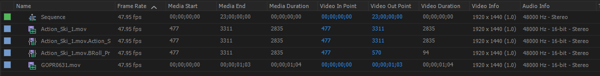

I am having a weird problem when transcoding subclips from Prelude. When I ingest the footage back in Premiere, the timecode of the footage is all messed up and displays a 3 or 4 digit number (ex: 3311 or 477.. etc) instead of the actual duration in a timecode format (00:00:00:00). The original clips are displaying fine in Prelude before transcoding. I don't know what the issue may be since I haven't seen this before. Is it maybe an export preference, or is it a bug?
I also tried to export a clip straight from Media Encoder using the same settings and when imported back in Premiere, the timecode is as expected, looking at the bottom clip in the image (GOPR0631). Also when importing the transcoded clip from Prelude two other subclip files come with it, which obviously I don't want, since I already pre-selected in Prelude and I just want all the subclips I defined treated as individual new files.

This might be due to the odd framerate.

It kinda confirms it, as I tried to export other clips in 23.976 from Prelude and it shows up fine. The framerate is 48fps and it's the majority of the footage. I have had only issues so far dealing with 1920x1440 / 48fps footage. Quicktime DNxHR didn't work at all with 48fps. I have used Cineform instead, which seems to work, but I do get this timecode issue. Any ideas or workarounds I might try? maybe a different codec?

I have tried exporting the subclips from Premiere, the same thing happens as it goes via Media Encoder anyways. Media Encoder doesn't have the option to set 48fps, for any of the quicktime transcoding codecs I tried (DNxHD, CineForm, Miraizon ProRes). The only way I managed to export the 47.95 was to match source in Media Encoder and it worked properly with CineForm and ProRes only, so I went with CineForm, but the timecode issues are still present with both codecs.
I don't know if it's a Prelude issue, since it's displayed as 47.951 in Prelude, Premiere and Media Encoder.
