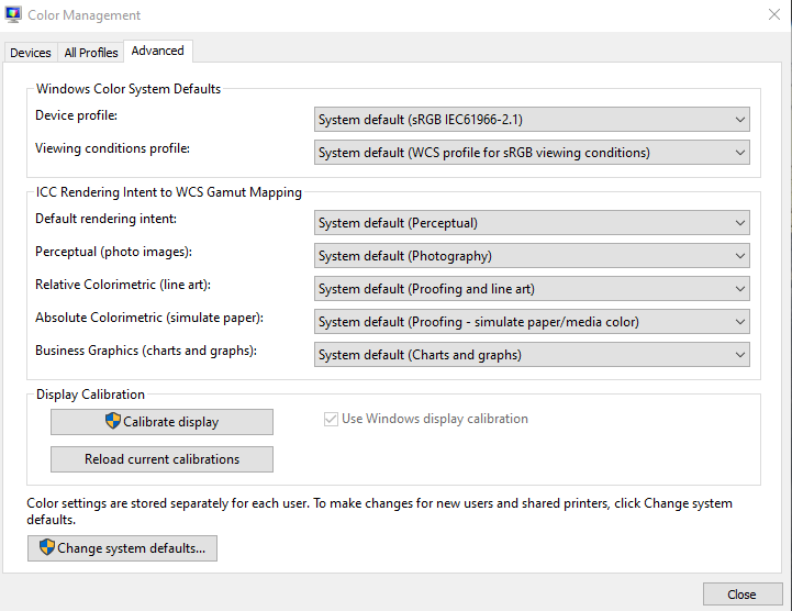

Here are my Windows color management settings, showing I've installed the ICC (using X-Rite)
Unless there is an error is my settings?

p.s. Did those Windows color management settings in the screen caps look OK ?  So hard to find accurate data in Google about the settings.  Too many variables.
