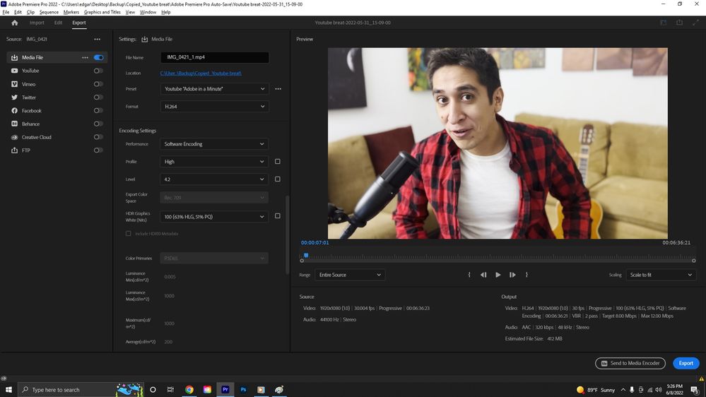

This is how it looks BEFORE I export it.
... and this is how it looks AFTER I export it.
I thought it was just my laptop until I switched it to my desktop and got the same result. That made me think it might be my export settings.
Here are my settings.
I've been stuck on this problem for weeks! Please help! I just want to release the video!

@Ann Bens nailed it. Long-term, your Sequence should be in a REC709 Color Space & bring your Exposure down in Lumetri Color until it doesn't look overblown.
If you're not exporting mixed footage, you might be able to get away with exporting in the HLG color space.
Under your Video Export setting, click the "..." for more settings. Change Profile to "High10", then you can change the Export Color Space to HLG 2100 (or REC 2020, whichever color space your footage/Sequence is).
