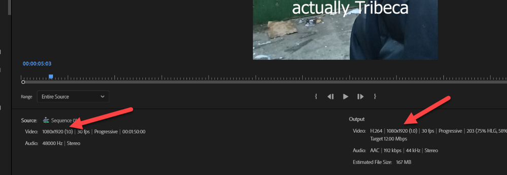

Thanks.  I right-clicked on my most recent exported video in File Explorer and I see that it is 1920 (W) x 1080 (H).  So that's a problem.  When I go to Export, I saw that my Source dimensions were 1080x1920 but my Output dimensions were 1920x1080.  So I changed them in the Video box.  I got a message about some error but clicked out and was able to Export successfully.  This has taken an entire day.  I'm on a 24" monitor and so the type is pretty small and I didn't see that the Output setting had switched the 1080 and 1920.  I assume that's what was happening all along.  Frankly it's rather infurating.  Wonder why the default isn't a match.  And why would clicking on Match Source not make them match up, which I did?  Anyway, now I know.  I'm not going to even mess with trying to make the dimensions 1080x1350 for my feed.  Thank you for your help.

Well, glad you got it going... it get's eaiser! 🙂
Strange it was correct on your initial screenshot:
Contributor ,
Nov 15, 2024 Nov 15, 2024
Yeah I see.  I dunno.  I wonder if there's another variable somewhere which if wrong would override this.  Anyway glad to know it gets easier!
