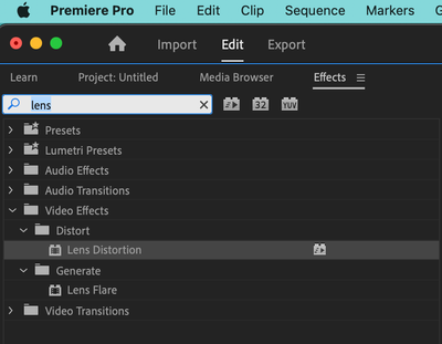

With the settings shown above:
1) Drag "Lens Distortion" from the Video Effects>Distort section of the effects menu onto your GoPro clip.
2) Simply pick "Curvature" within the Lens Distortion Menu within the Effect Controls Panel and set it to -25.
3) Right click on the effect you've made within the effect controls panel, then select "save preset."
This should remove the fish eye effect.
From there, you can just drag and drop that bad boy from the "Presets" within your Effects Panel onto your GoPro footage and you will be off to the races.
Cheers!
