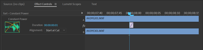

It can even be set to 0.01 seconds in practise.
See screen grab.
Another way to get in even closer is to reset the sequence setting to audio samples, rather than frames in 'Sequence Settings'. This allows you to zoom in a lot closer too

I did some testing with this and I think that even though you can manually set the audio dissolve duration to 1 frame, it's actually just doing a 2 frame dissolve...  You can change the timeline to "show audio time units" which allows you to keyframe audio levels down to the individual sample level...  which will allow you to get really precise audio edits...
And you might consider sending stuff to Audition which has a more robust (if more complicated) interface for this kind of work.   I've included a screen shot showing how to set up "show audio time units" which is accessible via the hamburger menu at the top left of the sequence window.  If any of this is not clear, post back and I'll try and explain in more detail.  Haven't had enough coffee yet.  Just saw Neil's post so realized this is somewhat redundant.     show audio time units.png
Apr 13, 2022 Apr 13, 2022
and just tested adjusting duration of a dissolve when you "show audio time units" and it allows you to set it to much smaller increments...  Ya learn something every day (or you should at least try).
