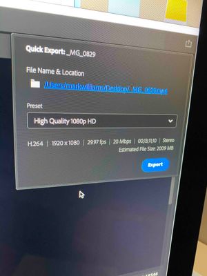

Hi Neil,
I use the icon on the top right of my PR screen and export as 1080 file to my desktop of my computer.
FY I all videos were minimum 1080 or 4K and the still images are high resolution files. The total video is 1.12GB (13 minutes) but the viewing size is tiny for some reason.  Didnt experience this on my first attempt with first video i made.

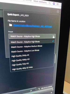

Now we're talking Neil. Where did you access this export settings ? I don't see any such window or certainly with so many options and therefor didnt inadvertantly select something as I dont have many choices (see image below of drop down).  Most of my exports will be either to FB or Youtube but neither how up.
I export in "high quality 1080 HD" as this is what i'm told the likes of Youtube uses ...or 1080 anyway.

I noticed on your drop down and do take your point ... to "Match source" so I have now chosen "match source high bitrate" and will see what it does  (in 50 minutes which is apparently how long this baby will take to upload to my desktop)  ;(
However is there any other method of exportingthat I am not aware of as I chose the top right link which is "quick export"

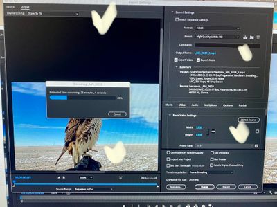

Gerik
I think I found it by clicking on file, export, to media. Here there is your screen shot and are various settings. I note the option to scale to fit or scale to fill amongst other settings. Then at bottom same window is percentage and i put 100%, (even though in the program window it stated that anyway). I also selected 1080 dpi high quality in the present dropdown. I didn't risk clicking the Match source box in the basic video settings segment but it does show 1080 and in the bottom of the same window I also didnt choose "use maximum render quality" at this point.  I'm uploading it and will see what comes out but already i see the screen size has increased when adjusting scale to fit and 100%.
Previously I had used "quick export" icon but this seems the way to go doing it this way instead.  I should make a short video to experiement with various upload options using this window.
thanks
Explorer ,
Mar 08, 2021 Mar 08, 2021
Not quite sure how these will all turnout at this stage as its still uploading but it seems these 4 key points ticked here will effect image/video physical size. What i'm still unclear about is what I did in creating the video that caused it all to be reduced in physical size when uploading.  I see right away when i changed setting to 100% at the bottom of the source screen that it physically increased the size of the image in that screen. Fingers crossed this fixed the issue.
