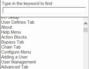

Hi all,
I'm using RoboHelp HTML 2015. I'm generating using a customized WebHelp layout and converting to a CHM, but the index is not indenting the sub-entries. The index does not appear to be in alphabetical order (even though it is). I have tried outputting to different WebHelp skins (WebHelp and CHM converted to WebHelp) and they all have this problem unless I select Pure HTML. I 'd prefer to use DHTML > Pure HTML to keep the Synch TOC and Search Box in Toolbar options. The same index in CHM files not converted from WebHelp and HTML5 output looks as it should. How can I control the way the index entries and sub-entries appear in WebHelp?
WebHelp with the incorrect index formatting:
CHM with correct index formatting:
Bonus question: At least one of my index entries shows a popup when you select it. None of the other entries do this. How can I avoid this popup from appearing on any of my entries?

That's exactly what was happening. The modified files were left in the directory after the uninstall and reinstall. After I removed those files, the reinstall worked and the index is properly indented.
Thanks for helping me fix a user error!
Scott

Thanks for the suggestion. I tried turning off the binary index, sorting the index, even using the smart index wizard. No luck on any of those. I still have the problem of WebHelp output using DHTML > Pure HTML not indenting the index sub-entries. I believe the file "whihost.js" controls the index, but I have no idea what I need to change to make this work correctly. Can anyone point me in the right direction?
Thanks in advance.
Scott

The index indents the sub-entries correctly if I output directly to CHM, HTML5, or WebHelp using the Pure HTML option.
The index indents the sub-entries incorrectly if I output to WebHelp using the DHTML > Pure HTML option.
Try creating a new layout, not a copy.
