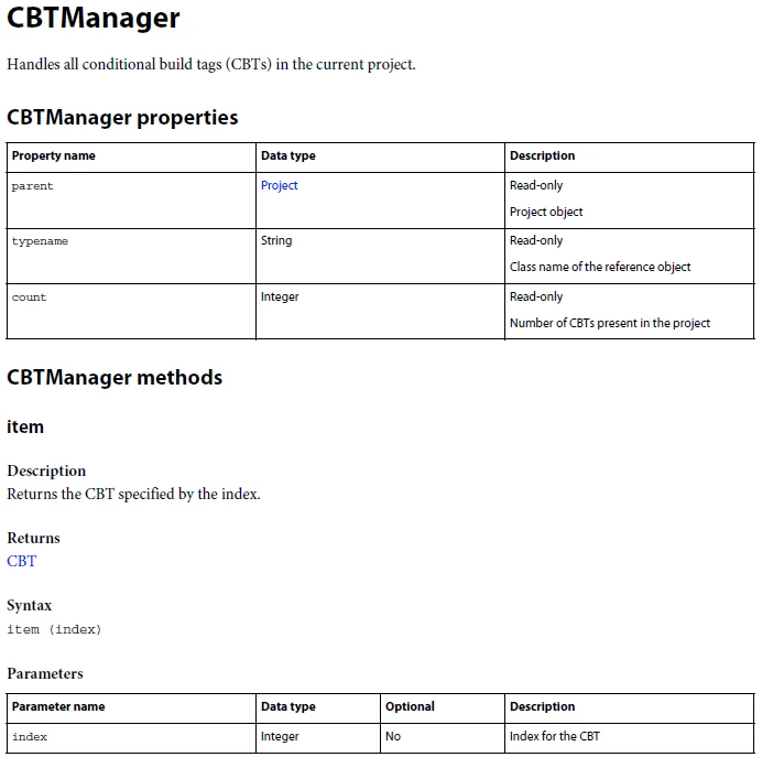

The documentation is saying this:
So i tried the following:
   var CBT = RoboHelp.project.CBTManager;
   var CBTItem = CBT.item[0].name;
But all I get is [undefined].
CBTItem.count is returning 3 which is correct. My project has 3 CBT's defined.
But I want to know the names !!
The Documentation is saying the CBT has these properties, but I can't read them.

    The CBT is a sub class of the CBTManager. You cannot directly use this object. Instead you need to load a specific CBT using the CBTManager.
    In post 4 you load all CBT's into a new array. That's the way to do it. For instance:

    The CBTManager starts counting at 1. A little counterintuitive, but a rule of thumb: When the object has a count method, start with 1. Regular arrays start with 0 as in normal JavaScript.
    var CBTM = RoboHelp.project.CBTManager;
    for(var i = 1; i<=CBTM.count; i++) {
         var CBT = CBTM.item(i);
         alert(CBT.name);
    Greet,
    Willam

    The only problem is all the iterator in RoboHelp Scripting object model starts from 1 and not 0.
    This is very much similar to Office macro support. so you should call
    var CBTItem = CBT.item[1].name;
    And it should work fine for you.
