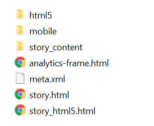

    Thanks so very much, Rick, Jeff, and Peter. I've have now successfully inserted Storyline (SL) output into RH, and it plays!
    One thing I can clarify:  after getting the entire SL output folder into my RH "contents" folder (via File Explorer), I then edit my RH TOC and drag the SL starter file, only, from Contents into my TOC. I do not need to bring the entire SL output folder into my TOC.

    Hi Martin, maybe I can help out here.
    I'm working with RH 2019 (new UI) for about a year now, and added a bunch of e-learning courses made with Storyline like you want to do.
    Other than you, I'm pulishing to a web space on a cloud service, not to Sharepoint.
    And other than you, I'm hosting the e-learnings on the cloud service in a separate web space so I could link to the starter .html file by URL.
    At first, I added the this link to the ToC like Peter suggested. The downside of that method was that there was no way to tell "open the e-learning course in a new browser window or tab". I tried to write the target="_blank" attribute at the <a> tag into the ToC directly (since it's pure XML you can open the ToC file with any text editor or code editor and add this attribute at that one link).
    But that didn't work out well, it was just being deleted from the file during generating the output.
    The best way we found to "embed" the e-learning courses with a fair user experience is making a topic and placing some links into the description. That's easy for us because the content is in a web space anyway. Maybe for your use case with publishing on Sharepoint, you should first publish the e-learning content there and pick the URL to the story.html (or directly to the story_html5.html) file to place it into a web link in RoboHelp.
